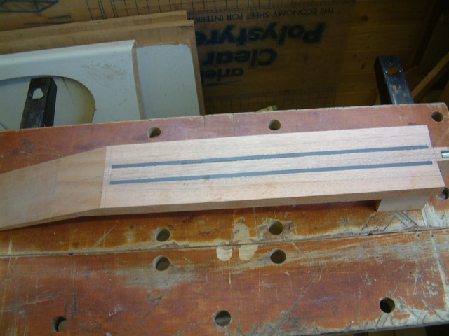

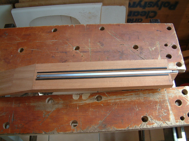

PostPosted: Wed Dec 13, 2006 7:59 pm
Chris,
The rods fit snugly in an 11mm routed slot - no rattle. The flat metal side goes against the fretboard, You can do them with or without a wooden fillet but now I use a fillet as I like the flat wooden look of the neck before the fretboard is glued on:
